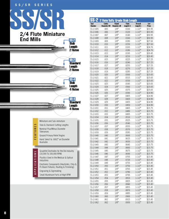

RobbJack

Gasawdust -- the bits from Drill Bit City are great and very cost effective. For rosette's I'd be careful as all of the ones I have purchased from them have been up cut bits which are not what you want to use for cutting rosette channels in spruce.
I use their bits a lot for cutting inlay pockets where a fuzzy edge on ebony doesn't matter.

Rod, I checked the RobbJack site and couldn't find 1/8" shank bits.

[QUOTE=Anthony Z] Rod, I checked the RobbJack site and couldn't find 1/8" shank bits.[/QUOTE]
Anthony, did you only look at the woodworking catalog, check out the main catalog, the first several pages have sizes as small as 0.005" with 1/8" shank bits. Actually, most of the series of end mills have 1/8" shank bits. They have more than you could shake a stick at. 2 flute, 3 flute, 4 flute, ball end mills etc...

Thanks Rod -- are they upcut or downcut spirals?

[QUOTE=Anthony Z] Thanks Rod -- are they upcut or downcut spirals?[/QUOTE]
You can get both
